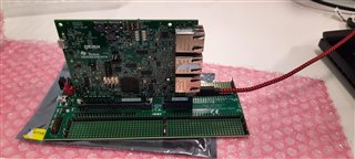

I'm not sure what I'm missing but I'm having issues powering on the board through the USB C connector.
See pictures below:

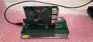

  • It works when the board is powered from Mini-USB connector
  • Doesnt work when board is powered from USB C connector
Can anybody please help ?

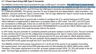

  • I haven't got a TMDSCNCD263 to try but section 3.1.1 Power Input Using USB Type-C Connector in AM263x Control Card User's Guide explains that the USB C power source needs to advertise that it can provide 3A at 5V:
    What are you using as the USB C connector power source?

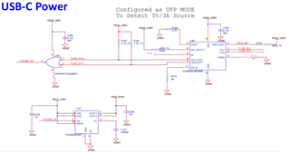

    I agree that wouldn't expect that to consume 3A, given that it works when powered using the Mini-USB C connector (a max of 0.5 for USB2.0 or 0.9A for USB3.1). However, the way the TUSB320LAIRWBR USB Type-C Configuration Channel Logic and Port Control has been used to enable the USB-C power input means unless the USB-C power source advertises it can supply 3A the control card won't be powered:
    Since the ADDR pin on the TUSB320LA is not connected the TUSB320LA is operating in "GPIO mode". Both TUSB_OUT1 and TUSB_OUT2 must go low for TPS2296_EN to go high to cause the TPS22965DSGT load switch to power the TMDSCNCD263 from the USB-C 5V input.
    TUSB_OUT1 and TUSB_OUT2 will both only go low when the USB-C power source advertises it can supply 5V 3A using the USB power delivery communication over the CC lines.
