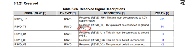

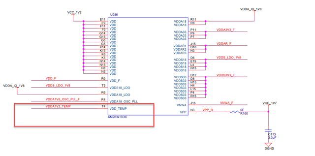

There seems to be is a documentation missmatch between datasheet (SPRSP74 – MARCH 2022) and demo circuit. (AM263x CC ) PROC110E1
https://www.ti.com/lit/zip/sprcak1
Table 6-86. Reserved Signal Descriptions
RSVD_T4 Reserved (RSVD_T4). This pin must be connected to ground (VSS)
vs
Here RSVD_T4 is connected to VDD
I assume the demo board is correct.
Please confirm.

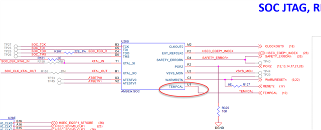

2nd question:
RSVD_U1
In the demo board a TMP411ADR is connected to RSVD_U1.
Is here a function description missing in the datasheet or can I also connect a TMP411ADR ?
