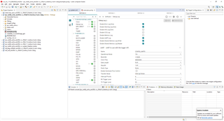

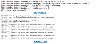

I am trying to get the ipc_notify_echo project compiled in gcc, I succeeded in my attempt but getting incomplete output when run on the AM263x-cc device via CCS Launch, Load and Run.
As of now, I am only getting the prints of the main core on the UART console, the debug logs of the other cores, i.e core r50-1, r51-0, r51-1 are not getting printed.
Note: 1.  For this application, r50-0 is running freertos while other cores are running nortos.
 2.  The same sysconfig settings gives the expected output with the tiarmclang compiled version of this project.
Kindly help.

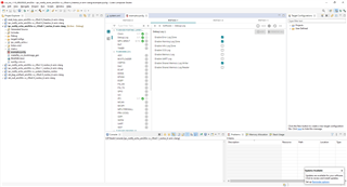

    I also noticed that the "Debug Log" in CCS project for R50_0 is different than the others. That might be the reason why the other cores' printfout do not come:
    vs
