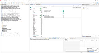

    Now something interesting happens: I can set SW or even a HW-breakpoint into the abort-functions of the sdk but it does not trigger. what instead happens if the abort occurs: CCS shows me "A reset occured on the target" for the core which throws that abort. I can then just connect to it and it stays inside the abort-function.
    This only happens sometimes. If I step through my code with some more SW breakpoints it runs fine every time.
    Additionally: if no symbols for that app are loaded in CCS it will somehow really catch that HW-breakpoint inside the abort-handler. CCS tells me in the call-stack that it may come from a HW_WR_FIELD32_RAW, but in CCS all the given values to that function are 0 and nothing more.
    I had a look at the registers of the SoC but I can't figure out which ones give me more information. Inside the abort-registers I see the following:
    the value of R13 would link to the TCMB. at this location our .undefinedstack is located. the R14 links to the HW_WR_FIELD32_RAW

    the abort is ending in the HwiP_data_abort_handler. Investigating this a bit further:

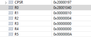

    this is the HW_WR_FIELD32_RAW disassembly. So I looked at the four registers, where the arguments are stored:
    the address of 0x28001040 is in the range of the ADC0 and exactly this address seems to be the adc-control-register.
    We are using the ADC so this could really be the issue but I do not understand the timing problem here. The call seems to be a call to ADCPowerUp().
    Seems like this one comes too early?
    I could track it down with doing a hw-breakpoint at the start of ADCPowerUp() and at the end of the function (where the asm-pop is called). This start is reached but if I continue running it runs into the data-abort and does not reach the end of ADCPowerUp().
    Seems like I found the faulty one.
