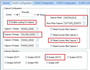

Hello.
I have configured the eCAP1 register via halcogen. When i try to feed the square wave of 50% duty cycle and 1 Khz frequency i dont see any updates on ecapREG1.CAP1-CAP4. but when i feed the input with 500hz i can see the updates on the timing registers(cap1-cap4). i tried with prescaler and it updates max to 800 hz.
Question is is there a limitation for higher frequency and duty cycle on ecap or am i missing any configuration?
My halcogen configuration for eCAP1:

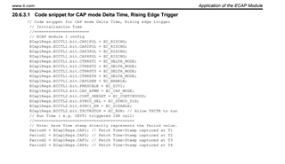

i am trying to use the below mentioned configuration in manual for TMS570.
any pointers would be helpful.
