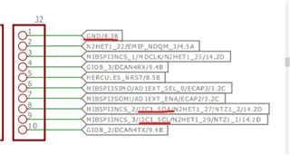

Using the LAUNCHXL2 570LC43 development board, the customer attempts to communicate with I2C devices on other boards using the two pins of I2C1 that are brought out on the board. J2 numbers 1 (GND) 8 and 9 are used in the figure below and are connected to the GND and I2C pins on the other boards, respectively.

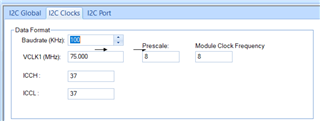

HALCoGen configuration is as follows:
The customer calls the i2cInit() function in the main function and tries to communicate with the device, but the program is stuck in the i2cIsMasterReady or i2cSendByte function. Grabbed both pins with an oscilloscope and did not see any waveforms. Can it be connected directly like this?

  • Hi Cherry,
    #1, Are I2C SCL and SDA pulled up through resistors? The TMS570 development board doesn't have external pull-up resistors on I2C lines.
    Both I2C SCL and SDA lines are "open drain", so the I2C module can drive SCL and SDA Low, but cannot drive them High. For those two lines to be able to go high you must provide external pull-up resistors.
    #2, On TMS570LC43x device, the I2C signals are multiplexed with MibSPI signals, and the pins are used for MibSPI by default. Did you configure the pinmux?
    The slave device to be communicated has a pull-up on the board and the customer can communicate directly with that device using another development board (verified).

  • the MibSPI module is not enabled in Driver Enable, only I2C1 is enabled, do they still need to configure the pinmux?
    Yes, the pinmux should be configured regardless of if the module is enable or not.

  • Hi QJ,
    The customer has PINMUX configured in HALCoGen, do they need to call muxInit() during program initialization?

  • do they need to call muxInit() during program initialization?
    The muxInit() is called in systemInit() in HAL code. The customer does not need to call this function again.
    After the I2C slave is connected, are SCL and SDA at HIGH level? If not, the pull-up on I2C slave board doesn't work.
    If the SCL and SDA are pulled up properly, the two lines should be HIGH, when you call i2CStart() API, the I2C module will issue a START condition and send the slave address.
