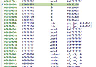

  • Debug snap for location 0x20000 after jump using
    asm(" mov r14, #0x20000");
    asm(" bx r14");
    assembly instruction

    After jumping to application from bootloader ,,  it goes to 0x0c address i.e. prefetchentry
    please have a look at cmd linker files

  • Hi Vijay,
    The application is loaded by Bootloader, and programmed to flash using F021 flash APIs. The ECC of application code is generated using F021 Flash APIs. Please don't use linker script to generate ECC for Application firmware.
    Fapi_issueProgrammingCommand((uint32_t *)dst,
                                                            (uint8_t *)src,
                                                            (uint32_t) bytes,
                                                             0,
                                                             0,
                                                            Fapi_AutoEccGeneration);
