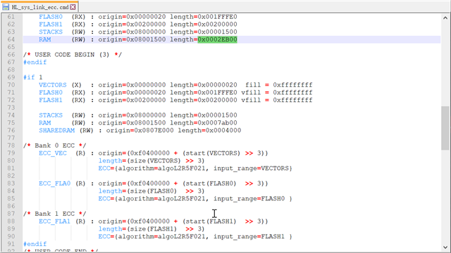

通过xds仿真器下载程序 CPU ERROR等亮,安装这个网址的说明以及您提供的cmd文件,编译的程序下载后无法执行。

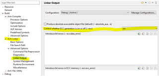

    1. Please turn on the ECC generation in CCS:
    CCS -- Project property --> ATM Linker --> Advanced Options --> Linker Output -->Control whether the ECC generation is ON or OFF: select ON
    2. When loading your program to flash, Please disable the following features:
    • Auto ECC Generation
    • Flash Verification
    • Blank Check before Program Load
  • 王工,按照上述步骤测试程序正常运行了,但是不理解使用J-Link仿真器下载程序,不会报出ECC error,使用xds仿真器(默认勾选Auto ECC Generation、Flash Verification),程序下载完成就会报出ECC error。
  • Hi Bo,
    Nice to know you have make it work.
    I don't know it either.
