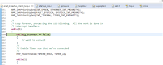

I want to connect my PC to my TM4C1294NCZAD over a direct ethernet connection using lwIP, and have been porting the lwIP project "enet_tcpecho_client_lwip" to do so (see SPNA 248: TM4C129x Ethernet Applications for Lightweight IP)
I am able to communicate with the MCU using DHCP over my company's network, but have not been able to connect using static addressing. Below is an image of my defined IP address variables. I defined the server (PC) address statically on my PC ethernet port. The last three lines are arbitrary addresses for the client (MCU) that match the server address.
When I use the IPADDR_USE_STATIC in lwIPInit and call tcp_connect (see two images below), the ConnectCallback function never gets called and the g_bconnect variable never gets toggled (see next two images).
lwIPInit
calling tcp_connect after lwIPInit
Connect callback function (never gets called)
above function never gets called, g_bconnect never gets toggled.
I have changed LWIP_DHCP and LWIP_AUTOIP to 0 in lwipopts.h (as per SPNA 248: TM4C129x Ethernet Applications for Lightweight IP).
Any suggestions or comments about why I am not receiving a connection signal from my PC and why my ConnectCallback function isn't getting called would be appreciated!

// Callback function when the client establishes a successful connection to
// the remote host.
err_t
ConnectCallback(void *arg, struct tcp_pcb *tpcb, err_t err)
    // char *string = "Hello World! \n\r ";
    if (err == ERR_OK){
//#if UART_DEBUG_OUT
//        UARTprintf("Connection Established.\n");
//#endif
        g_bconnect = true;
        // Register the callback function EchoReceive when
        // receiving data
        tcp_recv(tpcb, NULL);
        tcp_sent(tpcb, NULL);
//        UARTprintf("Sending a greeting message to the Server\n");
//#endif
        TcpSendPacket(g_string);
        return 0;
    else
//        UARTprintf("No Connection Established.\n");
        return 1;
// Function to create a LwIP client.
void
EchoClientInit(void)
    // Create IP address structure.
    struct ip_addr server_addr;
    // Create a new TCP control block.
    tpcb = tcp_new();
    if (tpcb != NULL)
        // Assign destination server IP address.
        server_addr.addr = inet_addr(SERVER_IPADDR);
        // Configure destination IP address and port.
        err = tcp_connect(tpcb, &server_addr, SERVER_PORT, ConnectCallback);
//        if (err)
//            UARTprintf("ERROR: Code: %d (tcp_connect)\n", err);
//        UARTprintf("\nPCB CREATED\n");
    else
        memp_free(MEMP_TCP_PCB, tpcb);
//        UARTprintf("PCB NOT CREATED\n");

    // Loop forever, processing the LED blinking.  All the work is done in
    // interrupt handlers.
    while(1)
    	while(g_bconnect == false)
    		// wait to connect
		// Enable Timer now that we're connected
    	MAP_TimerEnable(TIMER0_BASE, TIMER_A);
