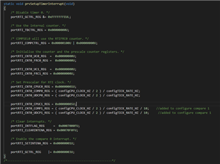

I've been having some issues with a project I am working on and figured somebody here might be able to provide some insight. The project I am working on is using the TI RM44L520 and I am currently trying to configure a 4-20ma chip over SPI. As I am using FreeRTOS for this project I need to implement a hardware timer to facilitate communication over SPI. Below I have posted the function used by FreeRTOS to configure the RTI used for the system clock and the code I have added to configure the second RTI compare on channel 1:

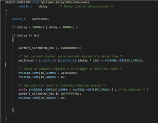

Next, I created the following hardware delay function using the new RTI compare:
After running this I did not get the expected behaviour so I placed a function that turned on some on-board LEDs to troubleshoot. What I found is that if I put the LED on function at the end of the hardware delay function all of the LEDs turn on as expected. If I place the LED on function under the hpiTimer_DelayInMicroSeconds() function call the LEDs do not turn on. I thought that this may be due to some error with the new RTI channel causing continuous interrupts so I tried disabling the interrupts on channel 1 at the end of hpiTimer_DelayInMicroSeconds() but the same error remained. If anyone has any ideas at all that would be a huge help.

    Does hardware delay function use RTI compare 0 or compare 1?
  • It uses RTI compare 1.
  • When I run the program I have been watching the RTI registers and everything with the timers seems to be working as expected. I have tried disabling RTI channel 1 at the end of the hardware delay function and reenabling it at the top and the FRC1 register does stop counting up as expected. When I do this the LED on function still doesn't run when called after the delay function has returned but does run when placed on the last line of the delay function.
  • The RTI is configured in prvSetupTimerInterrupt(), and prvSetupTimerInterrupt() is only called after vTaskStartScheduler() is executed.

  • The compare 1 interrupt is not enabled in your RTI setting in prvSetupTimerInterrupt():
    Is it enabled somewhere else?
  • Thank you for the replay. Right now I have channel 3 set to &rtiCompare1Interrupt. If I have the interrupt initially configured by the prvSetupTimerInterrupt() at the RTOS start time and I modify the registers during run time in the hpiTimer_DelayInMicroSeconds() function why would that function need to going into the VIM table? Wouldn't the hpiTimer_DelayInMicroSeconds() function just be used to set the registered and the rtiCompare1Interrupt be used in the background to create the interrupt. Sorry if I have a misunderstanding here
  • The compare 1 interrupt is enabled at the beginning of the hardware delay function
  • I did this so I can enable the interrupts on channel 1 while the delay function is in use and disable it when it is no longer needed

    rtiCompare1Interrupt() is the ISR for RTI compare 1. The hpiTimer_DelayInMicroSeconds() is not a ISR and is called in a task or in rtiCompare1Interrupt(), right?
    Can I assume the hpiTimer_DelayInMicroSeconds() is not called?
  • Sorry about that I'll try and make my explanation a bit more clear. The hpiTimer_DelayInMicroSeconds() is a function that is called in a task. When I put the LED on function call at the end of the hpiTimer_DelayInMicroSeconds() function all of the LEDs turn on as expected, so the hpiTimer_DelayInMicroSeconds() function is being called properly. If I then remove the LED on function call from the hpiTimer_DelayInMicroSeconds() function and put the LED on function call in the task itself one line below the hpiTimer_DelayInMicroSeconds() function the LEDs do not turn on. For some reason, after the hpiTimer_DelayInMicroSeconds() function has been fully executed it never returns to the tasks main function.
  • Both compare 0 and compare 1 use counter 0, and compare 2 uses counter 1.
    But your code reads the counter 1 free-running register, and compare the compare 1 register who uses the counter 0 and counter 1 free-running register.
    Can you change portRTI_COMPCTRL_REG = 0x00000010U | 0x00000000U;  --> let compare 1 use counter 1?
  • I modified the line and I am still having the same issue as before.
  • What does your rtiCompare1Interrupt() do? The code execution jumps to the RTI ISR when the free running counter reaches the value in compare register.
    If  hpiTimer_DelayInMicroSeconds() is only to insert a delay, you don't need to enable the interrupt for compare 1.
    How about change this line to:
    portRTI_SETINIENA_REG &= 0xFFFFFFFD; //disable the interrupt for compare 1
  • That seems to fix the issue. I'm a bit confused about what the issue was.
