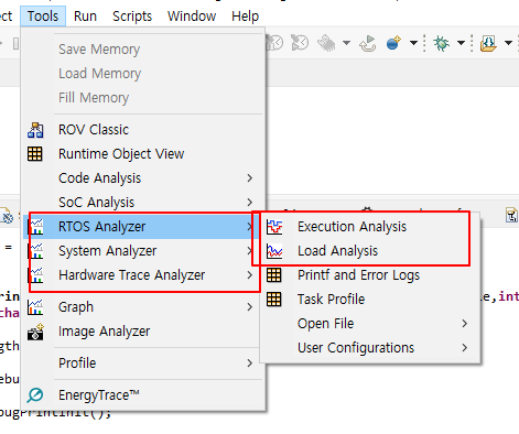

Is it possible to use below ROV functions - Load Analysis and Execution Analysis -with AM243x MCU+SDK?
If not, do we have a plan for this?

Hi SI,
Currently with MCU+ SDK, only "Runtime Object View" is working: AM243x MCU+ SDK: Using SDK with Real-time Object View (ROV)
There are some of the functions listed here implemented in the DPL: AM243x MCU+ SDK: Driver Porting Layer (DPL)
