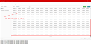

Hi, QJ , we communicated with the Flash 1BIT error last week, we modified the link file according to the file you gave us, But the ECC code corresponding to Flash has not changed and is still 0xFFFFFFFF. May I ask if we modified it in a wrong way?
The answer has been found on the forums,It should be that this needs to be set to ON,Isn't it?
Hi Xoahong,
Yes, the ECC generation option in CCS linker should be turned on.
