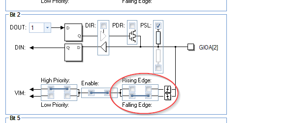

I am still new using TMS570LC4357 HDK, my goal is to trigger an ISR if there's a falling or a rising edge on GIOA[2] & [3].
After I setting in Halcogen as below, I need some example code to call the interrupt function.
Is there any example for that?

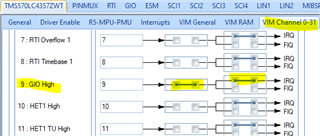

    You did the first step for triggering the interring with the falling edge:
    2nd step is to enable the VIM channel for GIO High (high priority is selected in your configuration):
    You will see the GIO ISR is generated in gio.c.
    Since the IRQ is selected, please enable the IRQ interrupt in your code:
    /* Enable CPU Interrupts */
    _enable_IRQ();
