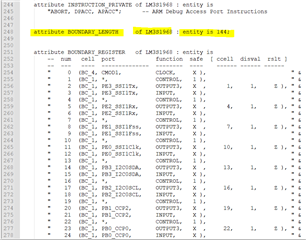

    Right now I'm working on two assumptions. One, I don't have the part in the correct mode to run a correct JTAG test and the other is that the BSDL file has some errors in it.  If it's the BSDL, I'd like to know that the extest file length is actually 144 bits long.  I'd also like to know if the individual register sets are all of the format: Input then Output then Control and that the control should be high in each case.
      Reading the BSDL file it says it is 144 bits long.
    I'm using this attached bsdl file. I hope we are using the same file.
