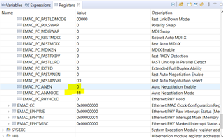

I am trying to adapt the enet_tcpecho_client_tirtos example NDK program to force a 100Base-T connection. Following another user's post, I added the following code to the initEMAC function in the example program. However, my network speed remains at around 10Mbps. See also the next two images showing that ANMODE in the EMAC0 register EMACPC remains 1 (auto negotiation enabled), even though the EMAC_PHY_FORCE_100B_T_FULL_DUPLEX macro should disable auto negotiation.
What am I doing wrong in my code?
initEMAC function with 100Base-T force code:
EMAC0 EMACPC Register view showing ANMODE = 1 (auto negotiation still enabled).
EMAC0 EMACCFG Register view showing FES = 0 (speed = 10Mbps).

  • I realized that I was using the wrong macro (AN instead of FORCE), and now my ANEN flag is 0. However, according to Wireshark and Task Manager, my speed is still maxing out at about 10Mbps. I'm using a simple modification of the example code to keep sending messages (send() inside an infinite loop) from the board to the PC. Do you know of any better ways of testing speed/bandwidth? Perhaps my current method is limiting my speed.

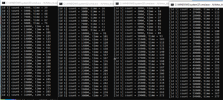

  • Hi Chester,
    Using your Throughput Test, I am now achieving around 26megabits/second in each direction (screenshot attached). So, about half of your speed.
    I tested this on the EK-TM4C1294XL Launchpad, as well as on my custom board, and got the same result for both (~26Mbps).
    Maybe there is something wrong with how I am setting up my command line instances for running tcpSendReceive? Attached is a screenshot showing my four command line windows running.
    Note: With one command line instance, Task Manager shows my Ethernet speed as ~21Mbps, and a second instance knocks it up to ~26Mbps. After that (adding a third, fourth), the speed doesn't change.
    Thank you.
    [Screenshot of Task Manager Ethernet Speed]
    [Screenshot of Four Command Line Instances]
