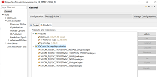

I am using a EK-TM4C123GXL board and I want to upload the usbcdcmousedevice example on my board, but the example will not compile. The full error output is this:
" error: xdc.cfg.Program: "D:/ti/ccs1120/xdctools_3_62_01_16_core/packages/xdc/cfg/Program.xs", line 71: xdc.cfg.Program : The package 'ti.sysbios.knl' is not compatible with XDCtools used in this build. Please either use XDCtools compatible with that package, or update the product containing that package, or rebuild the package with XDCtools 3.50 or later."
See attached for the setting.
I have seen this thread, but the question on this is about CC13xx and CC26xx MCUs, which use another version of SYS/BIOS (other folders/other version control etc). I already have the latest SYS/BIOS for my MCU (TM4C123) and I still get this error.
