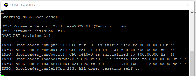

They tried it again using SBL_NULL, but still faced the 'UDMA RX Channel open failed error' as same before.
Their sysfw boot log is as below.

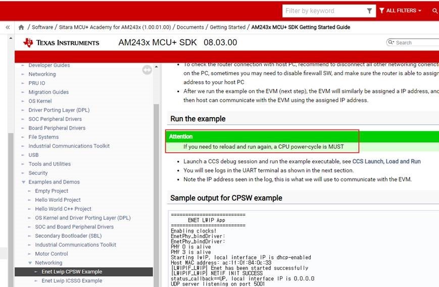

When they checked in MCU+ SDK User Manual, they found below 'Attention' which is 'CPU power-cycle is MUST' to run LWIP again as below.
Could you please provide details and let me know if there is any plan to improve this?

  • Hi SI,
    This can't be improved as reset is needed due to system firmware (who manages SOC resources) needs to be reloaded and rerun. Otherwise, the resource (in this case, RX channel) keeps locked/allocated from the sysfw point of view, causing RX channel allocation failure when asked by R5/LwIP app.
