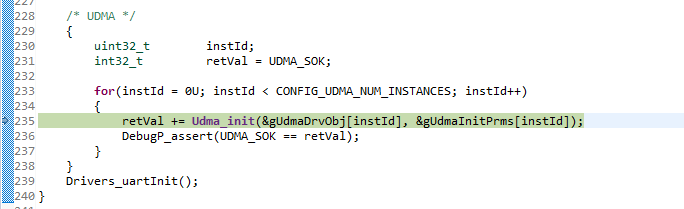

  • Hi Anand M,
    This issue can be reproduced using IPC example. e.g. in IPC example, you can reproduce this issue when System_init() was called after adding UDMA in UDMA Sysconfig as below.
    you can find there were differences in the values of '(Udma_DrvHandleInt)&gUdmaDrvObj[0] -> rmInitPrms -> startMappedRing[2] & [3]' and '(Udma_DrvHandleInt)&gUdmaDrvObj[0] -> rmInitPrms -> numMappedRing[6], [7])' of each cores.
    1) adding UDMA in SysConfig Core R0-0 and R0-1 as below.(instance PKTDMA_0)
    2) when you execute Udma_init(), you can reproduce issues, and you can find there were no resources allocated for R0-1.
    * Core R0-0:
    * Core R0-1: ==> you can find no resources allocated for Core R0-1.
    Thanks and Best Regards,
    SI.

  • Hi Si,
    Like I mentioned, the default boardcfg will mostly have resource allocations for the only the examples which we have tested, so if resources are needed on R50_1, it needs to allocated. For that the sciclient_defaultBoardCfg_rm.c file has to be changed, entries need to be added for R50_1, and then the boardcfg has to be regenerated (You have given the reference for this above). For example, in the current sciclient_defaultBoardCfg_rm.c file, around line 815, you can find an entry like this:
                .num_resource = 16,
                .type = TISCI_RESASG_UTYPE (TISCI_DEV_DMASS0_PKTDMA_0, TISCI_RESASG_SUBTYPE_PKTDMA_RING_CPSW_RX_CHAN),
                .start_resource = 128,
                .host_id = TISCI_HOST_ID_MAIN_0_R5_1,
    This is an entry for the allocation of PacketDMA rings for CPSW Rx Channel. If you pay attention to each of the members of this struct entry, what this means is that 16 PKTDMA rings starting from 128 for CPSW Rx Channel is allocated to MAIN_0_R5_1 'host'. The host is a different terminology used and is not to be confused with core names. MAIN_0_R5_1 here means R50_0, but non secure host. Had it been R50_0 secure host, it would have been MAIN_0_R5_0.
    Now if you want the same resources to be allocated for R50_1, you need to add an entry just like this one, with host id as TISCI_HOST_ID_MAIN_0_R5_3 (non secure R50_1). You can get a whole list of host ids in mcu_plus_sdk/source/drivers/sciclient/include/tisci/am64x_am243x/tisci_hosts.h
    Once the host id is changed, make sure that the resources used are different for each host. As in, default case you have 16 resources from 128 for R50_0. You can't have the same for R50_1. So split 8 resources each, or if you just want to run this from R50_1, remove the R50_0 entry. After making the changes in this file, please regenerate the boardcfg and rebuild the SBLs. Please try this and let me know what happens.
    Anand M

  • Hi SI,
    I don't see any issues in the logs. Unfortunately there is no explicit way to check if the modifications are applied other than checking the application. After rebuilding the boardcfg, the source/drivers/sciclient/sciclient_default_boardcfg/am64x_am243x/boardcfg_blob.bin would differ, that's a change noticeable. If you build the sbl_null then without the -s option, you can see that this binary is used in creation of the sbl_null.release.appimage image. I understand that the customer is trying the SDK 8.3. Let me know any more issues faced, I am waiting for your response.
    Anand M
  • Hi Anand M,
    Thanks for your response.
    Thanks to your help, they successfully rebuild SBL by modifying resource file in SDKv8.3, and they can find right resources would be allocated for other cores.
    SI.
