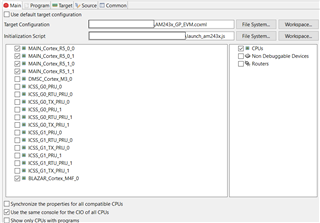

For the debugging I attach our board to an XDS110 JTAG Debug Probe which I plug into my computer over USB.
From the CCS Edit Perspective I launch the following Debug Configuration:
where the TargetConfig is set as follows:

Using the launch script, I start by bringing the board into NoBoot mode.
Then there is a check for the existence of sysfw.bin and sciclient_set_boardcfg.release.out, which succeeds.
Afterwards sysfw.bin is loaded and DMSC starts up on the M§.
But then the R5 tries to connect, which does not seem to work.
And I get said memory error right after that.

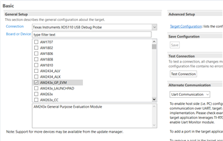

  • Hello Ming,
    so the error is definitive in the "_0" endings:

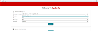

    It seems that at one point, as in my syscfg file that I use for our board it says "package =ALV",
    also to be able to open my syscfg file in the standalone SysConfig and not get the no-package error, I needed to choose the following context:
    I tried out to set in the CCXML the board to AM2434_ALV instead of AM243x_GP_EVM
    which as a result adds those "_0" endings.
    When that didn't seem to work, I set the board back to AM243x_GP_EVM, but the "_0"-endings stayed in the CCXML file.
    I don't know why those are added in the first place but maybe you have an idea.
    As this answer solves my problem, I will mark this as resolved but would be happy in case you have an idea why those endings are added, if you could elaborate on that.

  • Hi Philip,
    We confirmed this as issue/bug in our ccxml. Below is JIRA ID for tracking. I will let you know schedule once the fix version is assigned to this bug.
    SITARAAPPS-2257 - AM243x_ALV.ccxml file has invalid "_0"-endings
