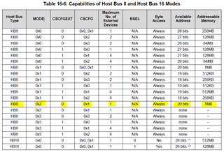

I found the below table in MSP432E401Y TRM. Here, it is mentioned like 512MB. Is it right?

  • Hi Maikkannan,
    What is the maximum size of flash memory can be connected with MSP432 through EPI ( External Peripheral Interface ) in Host-mode?
    You are correct, it is 512MB. Of course you will need to ensure your memory device is compatible with the bus requirements for this mode.
    We would like to put  8MB/16MB/32MB external flash. Is it possible?
    Yes.

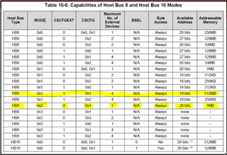

    2. In this below table, it is mentioned like 512MB. it is wrong. Instead of 512KB they mentioned 512MB.
    Thanks for noticing this, it is an error.
