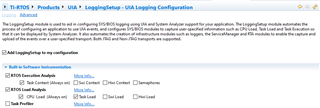

   I am using EK-TM4C1294XL launchpad kit with CCS v11 . I am unable to show the cpu and task load graph .

  • Hello Sumit,
    And which example project are you working with?
    Did you enable logging? That needs to be done as part of the configuration.
    Ralph Jacobi

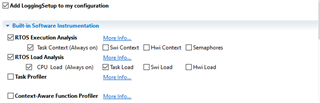

  • Hi Ralph,
        1. i am working with empty example(Led blinking)
        2. Yes i enable the logging in configuration
    I am getting empty graph like this
    Sumit Chaulya

  • Hi Ralph,
             I create a new project with Ti-RTOS, Here also i am getting same results(no graph).
