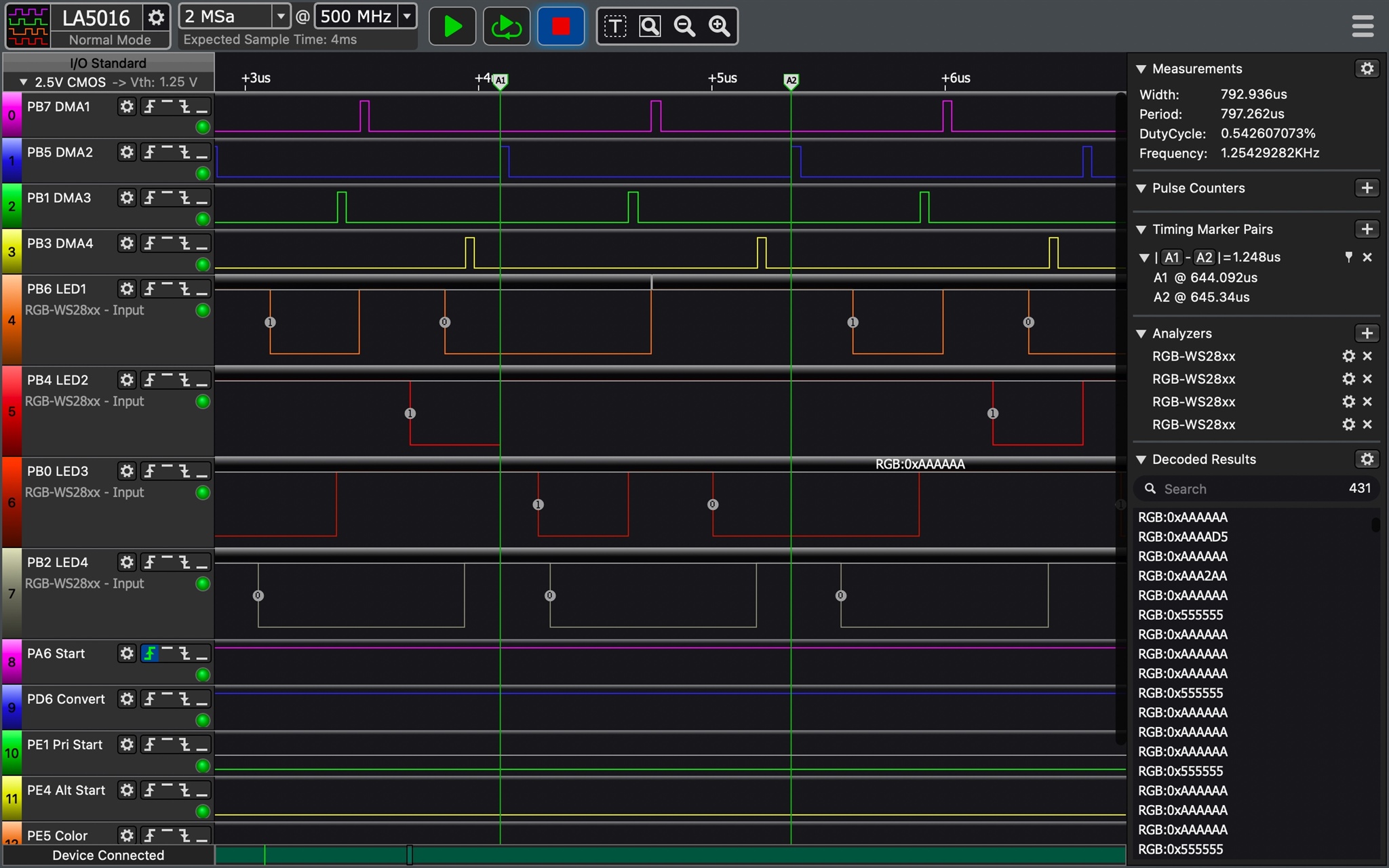

I use 4 Timers as PWM Mode.
Every Timer has his own DMA Interrupt Signal to transfer 1 Item from Memory to his own Match Register to Change the DutyCycle.
This is running good. But when I am activate uDMA for ADC Sampling to memory. My Timers PWM Signal sometimes is not running for one PWM Period.
Why? I test it so much to find the error. Iam out of ideas.
Here is a Picture. The failure is on channel 5 PB4 LED2. The Periode is complete high. When the uDMA signal comes to late, in the match register is an older value.

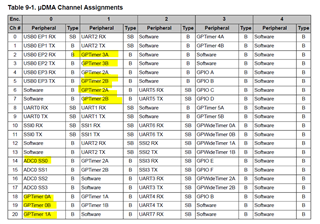

      - How many uDMA channels are you using in your entire application?
      - What are PB7, PB5, PB1 and PB3 on your capture? How are these signal generated? You denote them as PB7 DMA and so on. Are these signals generated by using uDMA too?
      - Which uDMA channels are you using? You can also answer by which Timer modules you are using.
      - What are the priorities among the uDMA channels? By default, the lower the channel index the higher priority. Therefore, ADC SS0 will have lower priority than Timer 3 but higher than Timer 0. But you can also set a channel to high priority. See below description.

  • Thank you for your quick feedback.
    I have the same problem sporadically with all 4 timers.
    But only if I record at the same time also with the ADC0 via uDMA.
    I have already tried to play with the priorities, but without success.
    I use the TIMER PWM Output from a GPIO and make wire bridge to another GPIO for the uDMA request.
    So it is possible to transfer one item per uDMA request. because the GPIO ports are able to use singe requests. These Signals are for the uDMA Request.

    I use 4 uDMA CHannels for the PWM Signals and 1 Channel for Sampling Data from ADC via uDMA to Memory.
    PB7, PB5, PB1 and PB3 these signals are created by timers.
    // Need to be bridged: PB7 <---> PA7
    // Need to be bridged: PB5 <---> PC7
    // Need to be bridged: PB1 <---> PD3
    // Need to be bridged: PB3 <---> PF2
    // Timer 0A is the data signal 1: PB6
    // Timer 0B is the udma trigger signal to GPIO: PB7
    // Timer 1A is the data signal 2: PB4
    // Timer 1B is the udma trigger signal to GPIO: PB5
    // Timer 2A is the data signal 3: PB0
    // Timer 2B is the udma trigger signal to GPIO: PB1
    // Timer 3A is the data signal 4: PB2
    // Timer 3B is the udma trigger signal to GPIO: PB3
    I use the uDMA Channel: 4,6,7,17 for the Signal and Channel 14 for the ADC0

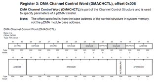

    void uDMAGPIOAIntHandler(void)
        // 1 uDMA Channel = 16 Bytes
        // Byte 0 - 3 = Source End Pointer
        // Byte 4 - 7 = Destination End Pointer
        // Byte 8 - B = Control Word <--- We need this adress offset
        // Byte C - F = Unused
        // uDMA Channel 4 Primary = 4 * 16 + 8 = 72
        // uDMA Channel 4 Alternate = (32 + 4) * 16 + 8 = 584
        if (uDMAControlTable[72] == 0 && uDMAControlTable[584] == 0)

    I need the ISR uDMAGPIOAIntHandler to switch off the signal. As soon as the uDMA Primary and Alternate Transfer are finished, I turn off the timer.
    Because this has to be done very fast, I decided to work without TivaWare Lib in this part of the code.
    But I don't change the uDMA structure. I check for 2 states in the uDMA structure. And turn off the timer.

  • Sorry, but the error is not gone.
    I have as you have written. I reduced the LED signals from 4 to 3, then to 2 and then to 1. I could not fix the error by doing this.
    The error with the timer comes only, if I send at the same time with the ADC0 music sample and then at the same time with the timer the Led signal.
    As soon as I send only the LED signal without sampling music with the ADC0, the timer runs.
    I have 2 problems with the timer.
    That one period disappears completely. Like on the picture above. (PB4 LED 2).
    Or the uDMA does not manage to update the match register in time.
    What can cause a timer period failure?
    If I use a LED signal i.e. Timer1A and Timer1B and at the same time with the ADC0 sample. Can this be a performance problem ?
