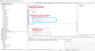

    I followed video shared by you and i just configured same as in video, i don't see any problem at my end.
    I just created one array to store 10 characters from SCI.
    After that i just called "sci_receive" and i initialized my array to it and i also mentioned length as 10. So that i will get a notification interrupt after i received 10 characters from SCI.
    I am setting one flag in notification function to indicate my receive operation completed. And in my while(1) loop, i am just verifying that flag to perform some action.
    I tested and it worked as per my requirement. You can just try this project on your end.

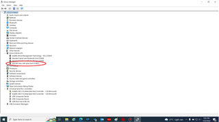

    You have to check your device manager and should configure same port in terminal window of CCS

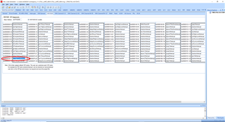

    I am sharing my debug video, please have a look
    If you look at that video, before debugging start my "rx_data" buffer is empty. And i configured my terminal with XDS port showing in device manager. After that i run the code and i got a message that "Please send data:" in the terminal. After that i type "a to j" letters(10 characters) in terminal that i received same data in my debug window of "rx_data" buffer.

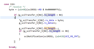

    ->I applied your code to mine and I see that data does not shift.
    Data will never shift in the "rx_data" buffer we are passing.
    If you verify above handler code which is present in the "lin1HighLevelInterrupt" function. Whenever controller SCI receives a new character, the processor executes the "lin1HighLevelInterrupt" function and particularly it comes to the case 11 as shown above. Here the received new character will be moved to the buffer pointer i.e. g_sciTransfer_t[0U].rx_data and after that rx length is decrementing by one and buffer pointer will be incremented by one to point new empty location in the buffer we passed, if rx length is not equal to zero then it will exit from this function and repeats the same process for next character as well. If rx length becomes zero means we received configured number of characters so in that case it will calls the sciNotification function.
    Note:
    The function "lin1HighLevelInterrupt" is calling because we are giving the same function name in VIM(Vector Interrupt Module) table, this is nothing but a loading function offset address into the vector table.
    also please note that we enabled only RX_INT
    So whenever a new RX_INT will get trigger and it calls the "lin1HighLevelInterrupt" function, and there it will read the interrupt status "sciREG1->INTVECT0" based on status it will execute the corresponding case.

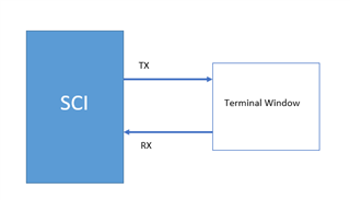

    Basically in SCI we have two lines, one for transmission and other for reception
    There won't be any cross connection between Tx and Rx until we forcefully short Tx and Rx externally(i.e. loop back). Both will work independently.
    If you write any data on sent data(array) and given to "sciSend" function then the data will transmit on Tx line of SCI.
    Similarly if we call the receive buffer with the "sciReceive" function, then any data from externa device over rx line will be moved receive buffer.
    In our testing we connected Terminal window in the place of external device for simulation purpose
    So when we call "sciSend" function with send buffer array then the data in the send buffer array will be moved to terminal window from controller over Tx line and after receiving data the terminal window will display the data.
    Similarly when we type any data on terminal window, it received to Receive buffer over Rx line from terminal to controller.

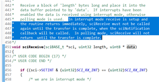

  • HI,
    I guess it is because of you are calling SCI receive function only one time. If you call it one time only then it will stop after required number of bytes received.
    Try to call it again, after receiving of first array to receive second array.
    After you received length number of bytes into array for the first time again call this function with same array and required number of bytes, then your array will update with new data.
