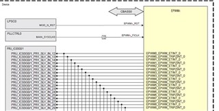

   I 'm verify AM243x EPWM function by using demo code epwm_duty_cycle_am243x-lp_r5fss0-0_freertos_ti-arm-clang in SDK8.3

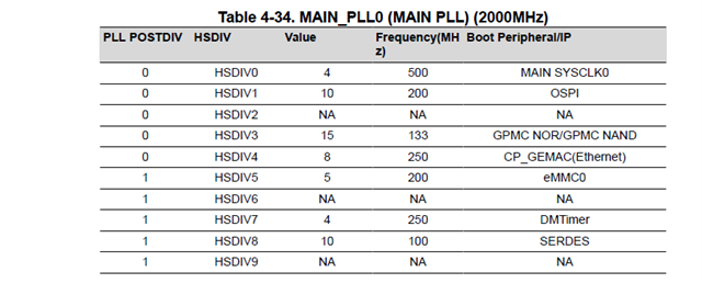

When I look into TRM, it shows the maximum TBCLK = FICLK and FICLK = Main_SYS_CLK0/2 =  400MHz.

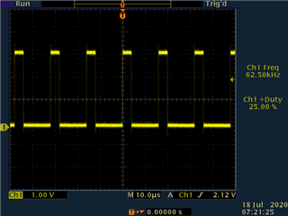

However, I found SDK setting  FICLK is only set to 250MHZ.  I try to generate 100KHz waveform by using FICLK=250Mhz and  FICLK=400MHz. I got wrong the waveform (frequency) by using FICLK=400MHz
Please refer to following two pictures:
FICLK=250MHZ
FICLK=400MHz
The only change in these two codes is
/* TB frequency in Hz - so that /4 divider is used */
//#define APP_EPWM_TB_FREQ                (CONFIG_EPWM0_FCLK / 1U)
#define APP_EPWM_TB_FREQ                (400000000)
Please refer to source code

 I would like to get confirm what is the maximum value of FICLK? or any limitation is EPWM resolution?
