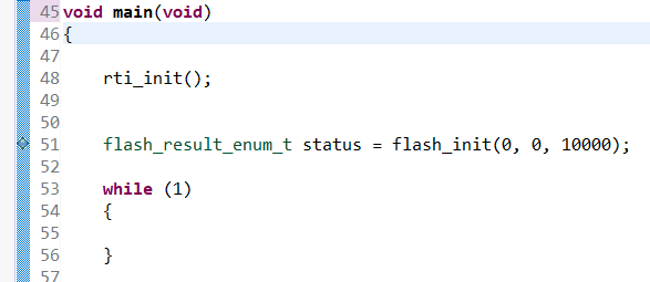

I'm writing a bootloader library with the TMS570LS3137 Mcu, but it gets stuck in the Fapi_setActiveFlashBank function, what could I be doing wrong? I am attaching images related to my code. I would be very happy if you help.

    From the your code in main(),  you are trying to write data to sectors of bank 0.
    All of the Flash APIs that program, erase, blank check or margin verify must be called from a bank other than the one in which code is being executed. If programming or erasing bank 0 of the device which has only one flash bank, these routines must be executed in RAM.
    I recommend that the you disable the interrupts before calling flash API.
    Please refer to my bootloader example in which the flash APIs are copied to RAM and executed from SRAM.
