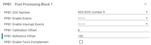

    I have taken your project and imported into CCS. I have changed my PPB1 reference offset to 100.
    I have left my Analog pin open and tried to see the ADC result and ADC PPB result values in the watch window. Here ui16ADC0Result and ui16ADC0PPB1Result are made global.

    I am able to see the PPB1 result as 100 difference with the ADC. It is working.

    I was able to further track down the root cause of the DAC port being stuck. What you are observing is correct. However in the DAC write function there is a check (DebugP assertion) in case the value is more (0x0FFFU). And as you might know the the example is writing within the ISR which should be avoided acc. to the DebugP comment section.
    If the input signal is close to 0 the the reference offset computation within one of the PPB's can become negative. If for example 0 - 1 is executed '0' being the ADC value and '1' being the value to be subtracted from the ADCResult register, the resulting value will be 0xFFFF. Writing this value to the DAC port using the library function will assert DebugP within the ISR which will finally crash the system ...
    That's why subtracting '0' did not do any harm and subtracting '1' did crash the system. So far so good.
    It points me to another problem. If I really want to use the offset correction I have to use the "PPBx Calibration Offset". This works as expected. Both the lower limit and higher limit of the ADC's conversion range is checked. There are no 'negative' numbers.
    But if I want to use the "PPBx Reference Offset" the numbers may become negative.  Therefore if I use this function I have to check for negativ numbers not being possible in the ADC0Result register but in the PPBx result registers 1.
    Using the DAC-Port example above. It looks like this for the PPBx Result Register 1. The negative numbers create a 'jump'. I know it can be explained. However I would have wished an option could be used to limit the low end of the result register 1 value as well. The way it is now, I will need additional SW to check for negative numbers in case I use this PPBx function. This can become tricky if speed is everthing.
