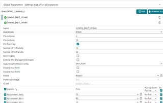

Trying to receive unicast UDP packets on one port, and multicast/broadcast them from the other.
To date, we have had NO success getting the second ethernet port to work. We have tried changing the ENET LWIP CPSW examples to target the second port instead of the first, and we can't seem to get the second port to work at all. I am sure there must be something basic that we are missing.

  • Hi Mark,
    Can you please provide below information?
    1. SDK version you are using
    2. Is this on AM243x LP or your custom board?
    3. Have you configured Enet LwIP example in switch mode?
    Please refer to enet_l2_cpsw_switch examples sysconfig & source code for enabling additional ports.
