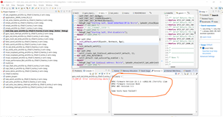

  • Hello Prasad,
    Are you using the SBL NULL flow or CCS load_dmsc.js based load?
    ->If i don't misunderstand now using SBL NULL.
    ->As you can see in this picture below is the progress i load "gpio_multi_led_blink" program:
    Do you do CPU reset before loading the program?
    ->Can you show me how to reset CPU by CCS?
    thanks!
  • ->Can you show me how to reset CPU by CCS?
    After reset core should look like below -
  • Hello Prasad,
    I do exactly with your suggestion. I reset CPU and load program into, but it have the same isssue.
    It is a abnormal issue, this is the first time i work with MCU that need re-load to run program.
    I dont understand why  program don't normal work if turn off power and then turn on again.
    thanks alot!

  • i just update for your question.
