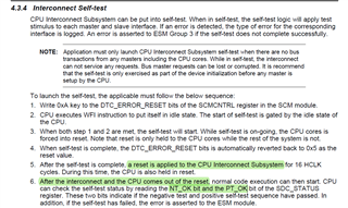

TMS570LC4357: MEM8: Interconnect Self Test does not set NT_OK and PT_OK bits but ESM 3.12 is not set
Part Number: TMS570LC4357
Hi experts,
According to section 4.3.4 (Technical Reference Manual), after running the interconnect self-test the NT_OK and PT_OK bit should be set and if the Test fails ESM 3.12 should be set.
In our case NT_OK und PT_OK and ESM 3.12 do not get set after running the diagnostic. In my understandig NT_OK and PT_OK should be set if ESM 3.12 is not set.
(Q1) What could cause this behaviour?
