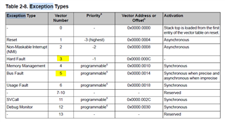

I'm using TI-RTOS with my TivaC. i want to know how to enable the bus fault under TI-RTOS "tirtos_tivac_2_16_01_14". so whenever the bus fault happens, it will jump direct to bus fault instead of hard fault.

      Bus fault is at 5 while hard fault is at 3. Please also note about the fault escalation for which you may be seeing.

    but I know why the escalation is happening. what i need to know, how can change the TI-RTOS configuration to jump directly to bus fault handler?
  • in other words, i have the below lines in one of my tasks
    void (*fun_ptr)(void) = 0;
    fun_ptr();
    this shall cause bus fault, but instead it jump to hard fault of type forced. while it should go to the bus fault. because i think that the bus fault is disabled. so how can i enable the bus fault from the TI-RTOS configuration .cfg?
  • To get this effect you would set the BUSFAULTENA bit in SCB->SHCSR (aka SYSHNDCTRL). It looks like TivaWare provides this as "IntEnable(FAULT_BUS);".
    I think writing this register requires Privileged Mode; I don't know whether that's easy in TI-RTOS.
    [Edit: Fixed typo.]
  • It occurred to me that your example (call-to-0) would more likely generate a UsageFault (Invalid instruction) than a Bus Fault. For this you would need IntEnable(FAULT_USAGE);". There's also MemManage (FAULT_MPU), though I think location 0 is executable.
