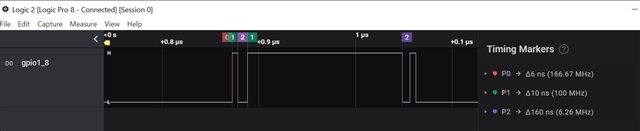

    I modified gpio_led_blink demo code in order to measure the latency for setting GPIO from high to low or low to high. My code is simple.
1. manipulate register directly without using device driver.
2. put the code to TCMA  by add a function to perform toggle infinitely.
void __attribute__((section("gpio_toggle"))) toggle_gpio1_8(void)
while(1)
*GPIO1_8_SET_ADDRESS = GPIO1_8_MASK;
*GPIO1_8_CLEAR_ADDRESS = GPIO1_8_MASK;
linker command file
GROUP {
gpio_toggle: palign(8)
} > R5F_TCMA
3. set build environment to release mode and change optimize level to fast.
4. program to device and measure it.
Attachment is my project files. I use SDK 8.3
gpio1_8_toggle_am243x-lp.zip
Here are measurement result.
According to the measurement, the latency to toggle GPIO is 184ns but from datasheet.
The minimum pulse can be 3.6ns + 8ns * 0.975 FICLK = 500Mhz /4 =125MHz = 8ns.
The gap is huge, may I know is this typical value by using GPIO module to toggle GPIO?
How do we get datasheet result?

  • Aakash,
        Thanks for your response. I follow your suggestion and  modified MPU setup.
    As the result: the minimum latency become 6ns. However, the timing of GPIO become unpredictable. The maximum time is 160ns which is 10x them minimum one.
    I used debug mode and load code into device to check the difference between before modified MPU setting and after.  The assembly show they are identical. You can see these two files: strongly_ordered.txt and mpu_optimized.txt

    The R5F pipeline impact a lot.
    However, for I/O area, I think strongly ordered is mandatory. We can't not  optimize pipeline without strongly ordered access I/O.
    I will recommend that we denote test condition for GPIO spec and provide some caution regarding pipeline optimization impact  in datasheet.
    Andre
