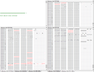

  • I highlight in yellow for BERFLAG at 0xFFFFF144, BEROFFSET at 0xFFFFF170 and both show 0. The ESMSR1 at 0xFFFFF519 is also 0. There is no DMA bus error as far as I can see unless you clear these flags in software. For experiment, Will you get bus error if you use SPI1 or other SPI3/4/5?
  • Sorry DMA Bus Error is G1.20
    SCI4.TX is active.  Also DMA between memory and CRC2 register in lower priority.  Also other peripherals are set in hi priority.
  • No BERFLAG because always 0 on this device.  TRM p. 751, section 20.3.1.42
  • Ok. I see the same note too. But your ESM is all zero to me. GP1.20 is not set in your memory window.
  • Sorry. The  last one was just before the error.  Here is the new one.
  • Here with Ozone-flagged register just after DMA Bus Error.

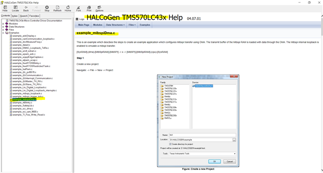

      Have you tried the HalCoGen MibSPI DMA example? If not, can you please try as is first and later adapt to your needs?
  • I do not have this code on hand and the platform I am working on is OEM.  Could you email me the .zip of the example and I will study it and see how easy I can insert it in my code as test-code.  Thanks.
