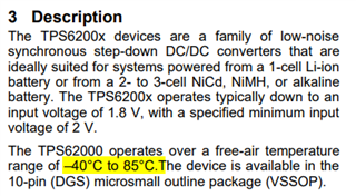

    The problem is created by the DC/DC converter that cannot provide 50mA at 185C - it is rated 300mA. The 3.3V drops under 3.0V and the supervisory circuit triggers a reset. I have tried with the converter set at 3.5V but at 185C the voltage still drops under 3.0V. With an external power supply on 3.3V the microcontroller works and the current measured is ~47mA.
      I don't have much knowledge on the DC/DC converter you use. Can the DC/DC converter support high temp at 185C and above? If it is rated for 300mA then why would it stop at 50mA? Is it temperature dependent, I'm really not the expert to answer it. Have you raised the question to the power management forum that supports TPS62000?
    Again, I'm not the expert on this DC/DC converter. Reading the datasheet of it, it says it is rated for 85C.

    The DC/DC converter used is TPS62000SHKK (TPS62000-HT), rated 210C, 300mA - in my board, based on my tests, it cannot provide 47mA at 185C. The voltage drops under 2.92V triggering the microcontroller reset, the voltage recovers, the microcontroller starts again and reset again - being unstable, until the temperature drops under 180C when recovers.
    The three out of four boards work up to 185C but if I go higher, they have the same problem at ~187C. Maybe the board that fails at 182C has an external pull-up resistor (used for a RS232 communication) that makes the board to consume more power and trigger the failure earlier.
    Based on my tests, the main problem is the TPS62000SHKK DC/DC converter.
