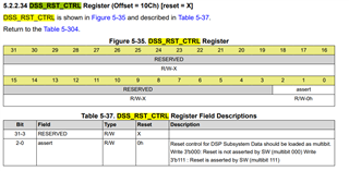

How AM2732 realizes software reset?
Hi Nancy Wang
We have a soft reset register which basically performs the reset. Here is the register
For DSP Sub system, you can checkout this register
Hope this helps!
