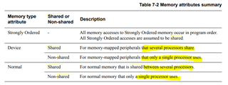

    Shareable has a specific meaning --> shared by several processors. The TMS570 device has lockstep configuration, and the 2nd CPU core is a checker/ diagnostic channel and it does not act independently. I think the shared and non-shared doesn't make any difference on TMS570 devices.

    Please read the description in ARM TRM: DDI0460D_cortex_r5_r1p2_trm.pdf
    The shared or no shared means between the processors, rather than the bus maters in the devices.
