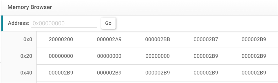

Hello
I have a minimal program which fits in the first kB. The hex-tools output produces the intel hex file. It shall be loaded with Uniflash.
However, the .hex file is somehow not written, the memory region from 0x00 to 0x400 remains cleared (0xff).
If I try with the .out file it works. If I try with a greater .hex file (merging multiple hex files, the region after 0x400 is correctly written.

  • Lothar,
    I will give this a try.  I should be able to reproduce this quickly and then get a test case put together for our UniFlash team to look at.  The trick is to find a TM4C123G board.  I have one somewhere.  I have the program and .hex created, just need to find a board to test on.
    John
  • Lothar,
    I found an LM4F120 board that seems to let me load small TM4C123G programs.
    Using UniFlash I can load a .out fine and a raw binary .bin.  Low addresses are being programmed ok.
    For the hex file can you send me the options you are passing to armhex?  I want to confirm that I am generating in the same way.
    John

  • Lother,
    Ok here is my test.
    First I erase the flash.
    Then I use the Memory view in UniFlash to read it and make sure it is blank
    Next I load the .out
    Read the memory
    Now I erase the memory again and read it back
    Next I load the .hex
    Read the memory
    So for me loading the .hex is working fine into low memory.  Note that I am not checking the box that the file is a binary as it is not a binary file.
    I also have a .bin file generated.  Testing that as well
    Erase memory
    Select to load the .bin, check the box for binary and specify the load address as 0x0000000
    Read the memory
    So for me I get the same result for the .out, .hex and .bin using UniFlash 8.0 on my LM4F120
    John

  • Lothar,
    So if I replace my .hex with the content from yours I see the same.  The memory is still all FFFFFFFF after loading.
    I also see this error when attempting to read the memory back:
    [8/15/2022, 11:58:58 AM] [ERROR] CORTEX_M4_0: Error: Debug Port error occurred.
    Really odd.
    John
  • I also see this error when attempting to read the memory back:

  • Hi
    Happy to hear that it's not just me.
    If I program and then verify I get the following (set to verbose):
    [16.8.2022, 07:26:16] [INFO] CORTEX_M4_0: Writing Flash @ Address 0x00000000 of Length 0x0000026c
    [16.8.2022, 07:26:16] [INFO] CORTEX_M4_0: Performing Mass Erase on Flash memory
    [16.8.2022, 07:26:16] [SUCCESS] Program Load completed successfully.
    [16.8.2022, 07:26:31] [ERROR] CORTEX_M4_0: File Loader: Verification failed: Values at address 0x00000000 do not match Please verify target memory and memory map.
    which makes sense as the memory is still 0xff.
    I enabled "Debug Server Logging" and added the output on the first post together with the GUI log. The file is huge and I didn't find any obvious error, except that percent always remains 0 ("percent":0), while in the working example, the percent sometimes shows a different value.
    Lothar

  • Something else interesting.  I can load the .hex in CCSv12 fine.  No error from the debug connection and the memory looks correct.
    However in CCS if I disconnect and then connect again the flash is all FFFF.
    If I clear this option in CCS then the flash is not erased when I disconnect and connect again:
    In newer versions of UniFlash it does a disconnect and then a connect after flashing. That is erasing the flash.
    So switching back to UniFlash I can make things work.
    First I click on the "Cortex_M4_0" at the top right and select to remain connected:
    Then I also clear the option to "Reset target during program load to Flash memory"
    John
  • Ok we know a little more about what is going on.
    In UniFlash 7.1 there was a change where we don't automatically do a reset after program load.
    As a result here what happens is you load the hex file.  The PC gets set to 0x0 then when it runs from there the flash gets erased.  You can actually see this a bit better in CCS as you can load the .hex and then just do asm steps until you see it get erased.  Why the program does this is not something I can answer.
    However if you load the .hex and then do a core reset the PC gets set to 0x25C which is after the code that is erasing the flash.
    So an easier workaround than what I have above is to click under reset options to get a list of available resets.
    Then select to do a core reset after the program load as this will ensure that it runs from 0x25C and not 0x0.
    John

    In both scenarios, the program runs after flashing but without that reset it runs from 0x0.  So something in the one image between 0x0 and 0x25C is causing the erase.  I suppose you could load the image in CCS and then open the disassembly view and put the starting address at 0x0 and it will show what the instructions are.
    John
  • Ahh know I understand, it's the application that erases itself by accident.
    It has indeed the tivaware FlashErase() function inside. By starting at PC=0x00, the vector table is executed as some random code and somehow it runs into the FlashErase() function which then erases itself...
    Through the reset, the PC is properly loaded from the vector table and the program runs properly, hence doesn't erase itself.
    Why would you run the program from a random address (0x00) as default?
    Does it mean I have to secure the FlashErase() function with some function argument value?
    Many thanks for above pointer.
    Lothar
