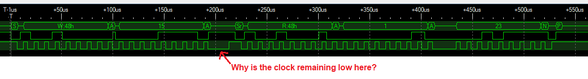

I'm using a Tiva Dev Board (TM4C123G) to read I2C from this AdaFruit temperature sensor.  I'm reading a 2 byte value from register 0x0F of the temperature sensor.  It works, the expected value is what I'm receiving (0x0117) but I'm wondering why the SCL line remains low after doing the first write where I write the address of the temperature sensor.  Here's what I've captured with a logic analyzer:

  • Hello Terence,
    I would guess it's because you used I2C_MASTER_CMD_BURST_SEND_START but only send one byte.
    For this use case, I would recommend you just use I2C_MASTER_CMD_SINGLE_SEND to send a single byte.

  • Hello Terence,
    So my typical experience with I2C devices has been that the correct usage is to use I2C_MASTER_CMD_SINGLE_SEND and which generates that STOP condition before the data read is done. That said, I was looking through the datasheet of the TMP117 and I can see the cause for concern with taking this approach given how the communication is outlined. The only STOP condition should be issued at the end of the transfer.
    The process of using a single send versus burst style commands really is set to dictate when START and STOP conditions are sent, so the way you've written the code would match the TMP117 datasheet in terms of when START and STOP conditions would be sent.
    That leaves the question of why the SCL line is low during that period of time. It isn't being controlled by the TMP117 as the datasheet explicitly states the device will not drive the SCL line so its the TM4C that is holding it low.
    My guess then is that the SCL line is being held low as the peripheral waits for clarity on what to do next. If it needs to issue a STOP condition, the SCL needs to be kept low from the last clock. So the state machine is keeping it low in anticipation of that until it received instruction regarding what next step should occur. I don't see any fundamental issue with that as the communication is on going at that time, and you have confirmed it is working fine.
