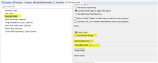

    However, when I download boot_demo_emac_flash using Code composer and run it, led doesn't blink. It is like boot_demo_emac_flash gets stuck somewhere.
      The boot_demo_emac_flash starts at 0x4000. When you use CCS to load the program, it most likely erases the bootloader at 0x0. You can use the memory browser to confirm that. The reason is that by default, CCS will first erase the entire flash before it loads the new program. You need to change the setting that it will not erase the entire flash but only erase the application space starting at 0x4000. See below to not erase the entire flash. When the bootloader at 0x0 is erased, the processor will not find the stack pointer and reset vector at 0x0 and 0x4 and therefore, not able to jump to the application at 0x4000 after a power cycle.

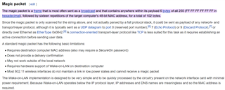

  • Hi Felix,
      Here is a description about magic packet from wikipedia. Magic packet is a broadcast message. In another, when the magic is sent by LM flash programmer, it does not really need to know the IP address of the destination. I'm interested to know what type of network are you having? Broadcast messages cannot work outside of LAN network. If your MCU IP address is not in the same subnet as your PC then the broadcast message will likely not work as it needs to cross the subnet and the switch on your network will block it to avoid broadcast messages. Please check with your IT department as I'm not the expert in the network systems myself. Check with your IT department if it is possible to have the DHCP server assign IP addresses for the client to be on the same subnet with your PC. See if that will resolve the problem. Another easier way may be to try the example on your home network. I think home network will be a simpler network that your PC and the MCU will be on the same subnet.
  • Hi Charles, thanks so much for the insightful information. You were correct. The problem seems related to the type of network configuration, specifically how DHCP and subnet mask are configured in the network. I tried a laptop computer which is disconnected from the company's network and it worked right away. I can consistently update firmware. I will bring in my application now and continue testing.
