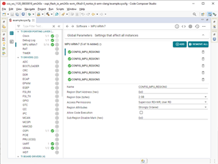

  • Hi Ming,
    Here is an image of what they see on SysConfig. Where can they change the GPMC settings like you have indicated?
    Mari
  • Hi Ming,
    Nevermind, I see what you mean.
    Thanks for the support. I will let them know.
    Mari Tsunoda
  • Hi Mari,
    Add a new CONFIG_MPU_REGION6 in MPU ARMv7:
    Ming

  • Hi Mari,
    The ARM MPU region was set up in order. The later regions overwrite the previous ones. For example, the CONFG_MPU_REGION0 is the default one which covers 2GB starting address 0x0. It was set to "Supervisor RD+WR, User RD" and "Strongly Ordered". It is good for all the MMR for peripherals.
    The CONFG_MPU_REGION1 is for TCMA 32KB starting at address 0x0. Since the region1 is overwritten the region0, so the 32KB starting address 0x0 becomes  "Supervisor RD+WR, User RD", "Cached" and "Allow Code Execution", the rest of the 2GB remains the same as defined in region0.
    The CONFG_MPU_REGION2 is for TCMB 32KB starting at address 0x41010000. Since the region2 is overwritten the region0 and region1, so the 32KB starting address 0x41010000 becomes  "Supervisor RD+WR, User RD", "Cached" and "Allow Code Execution", the rest of the 2GB remains the same as defined in region0.
    The CONFG_MPU_REGION3 is for OCRAM 2MB starting at address 0x70000000. Since the region3 is overwritten the region0, region1 and region2, so the 2MB starting address 0x70000000 becomes  "Supervisor RD+WR, User RD", "Cached" and "Allow Code Execution", the rest of the 2GB remains the same as defined in region0.
    The CONFG_MPU_REGION5 is for DDR 2GB starting at address 0x80000000. Since the region5 is overwritten the region0, region1, region2  and region3, so the 2GB starting address 0x80000000 becomes  "Supervisor RD+WR, User RD+WR", "Cached" and "Allow Code Execution", the rest of the 2GB remains the same as defined in region0.
    What they need to add is The CONFG_MPU_REGION6 is for GPMC 8MB starting at address 0x50000000. Since the region6 is overwritten the region0, region1, region2, region3 and region5, so the 8MB starting address 0x50000000 becomes  "Supervisor RD+WR, User RD+WR", "Cached" and "Allow Code Execution", the rest of the 2GB remains the same as defined in region0
    Ming

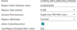

  • What they need to add is The CONFG_MPU_REGION6 is for GPMC 8MB starting at address 0x50000000. Since the region6 is overwritten the region0, region1, region2, region3 and region5, so the 8MB starting address 0x50000000 becomes  "Supervisor RD+WR, User RD+WR", "Cached" and "Allow Code Execution", the rest of the 2GB remains the same as defined in region0
    Given the described issue was an unwanted extra read seen by a FPGA connected to the GPMC, should CONFG_MPU_REGION6 be set to "Strongly Ordered" rather than "Cached"?
    If the region is marked as "Cached" the CPU could potentially generate speculative reads which could generate extra reads to the FPGA over and above those in the program.
  • Hi Chester,
    Thank you so much for your correction, yes, it should have been the "Strongly Ordered" instead of "Cached"
    Ming

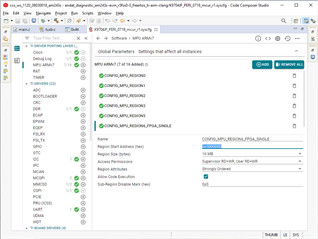

  • Hi Ming,
    Thanks for your reply. Unfortunately it seems that they are still seeing two accesses. I am attaching the syscfg file. Is there any other possible causes for this such as the errata mentioned in the beginning?
    https://e2e.ti.com/cfs-file/__key/communityserver-discussions-components-files/908/K9704JF_5F00_PERI_5F00_0719_5F00_mcur_5F00_r1.syscfg
    Mari Tsunoda
  • Hi Mari,
    The starting address for Region6 missing one '0'. It should have been 0x50000000.
    Ming
  • Hi Ming,
    Thanks, will ask them to fix.
    Mari

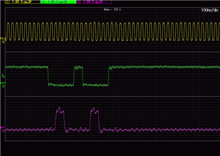

  • Hi Ming,
    Even after they fixed the address, they saw the same result. I have attached the waveform as below. Any other possible issues? Is this related to the errata mentioned in the original thread?
    Mari
  • Hi Mari,
    I talked to our AVV team. Here is what they came back:
    I looked at the waves, the phantom cycles are due to the masked byte enables in the requests made to GPMC, and translation from a 64-bit CBA bus to 32-bit OCP bus.
    For example, in the waves, one of the a CBA write to GPMC is
                    Addr = 0x1000_0000, bytecnt = 0x10
    byten = 0xF0, data = 0x0000_0001_0000_0000 (1st data phase on 64-bit CBA bus)
                    byten = 0x0F, data = 0x0000_0000_0000_0002  (2nd data phase on 64-bit CBA bus)

    This translates to following on 16-bit memory
                    Addr = 0x0, BE_n = 0x1, WE_n = 0x1, data = 0x0000 (1st 16-bit data not written – phantom cycle)
                    Addr = 0x2, BE_n = 0x1, WE_n = 0x1, data = 0x0000 (2nd 16-bit data not written – phantom cycle)
                    Addr = 0x4, BE_n = 0x0, WE_n = 0x0, data = 0x0001 (3rd 16-bit data written)
                    Addr = 0x6, BE_n = 0x0, WE_n = 0x0, data = 0x0000 (4th 16-bit data written)
                    Addr = 0x8, BE_n = 0x0, WE_n = 0x0, data = 0x0002 (5th 16-bit data written)
                    Addr = 0xA, BE_n = 0x0, WE_n = 0x0, data = 0x0000 (6th 16-bit data written)
                    Addr = 0xC, BE_n = 0x1, WE_n = 0x1, data = 0x0000 (7th 16-bit data not written – phantom cycle)
                    Addr = 0xE, BE_n = 0x1, WE_n = 0x1, data = 0x0000 (8th 16-bit data not written – phantom cycle)
    Since the phantom read/write is caused by 16 bit access, so maybe they can try to use 32 bit access.
    Ming
