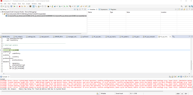

- If a debug build is loaded and  I attempt to load a program then I get this error:
"[ERROR] Dap: Error connecting to the target: (Error -1170 @ 0x0) Unable to access the DAP. Reset the device, and retry the operation. If error persists, confirm configuration, power-cycle the board, and/or try more reliable JTAG settings (e.g. lower TCLK). (Emulation package 9.7.0.00213)".
After pressing the Warm Reset the warm reset button at the right time, the log shows:
"CortexR5: GEL Output: Memory Map Setup for Flash @ Address 0x0CortexR5: GEL Output: Memory Map Setup for Flash @ Address 0x0 due to System Reset"
- Then if I hit resume in the debugger, this starts repeating:
"CortexR5: Error: (Error -1170 @ 0x0) Unable to access the DAP. Reset the device, and retry the operation. If error persists, confirm configuration, power-cycle the board, and/or try more reliable JTAG settings (e.g. lower TCLK). (Emulation package 9.6.0.00172)
CortexR5: Trouble Halting Target CPU: (Error -2064 @ 0x0) Unable to read device status. Reset the device, and retry the operation. If error persists, confirm configuration, power-cycle the board, and/or try more reliable JTAG settings (e.g. lower TCLK). (Emulation package 9.6.0.00172) "
However, the XDS110 has access the the warm reset pin and I can see on the oscilloscope that it isn't attempting to reset the device. I can also hit reset during this and it'll go back to:
"CortexR5: GEL Output: Memory Map Setup for Flash @ Address 0x0 due to System Reset"

  • Hi Renan
    You are correct. If the running code in flash makes the CPU enter an exception state repeatedly, and the CPU is not able to enter a debug state.

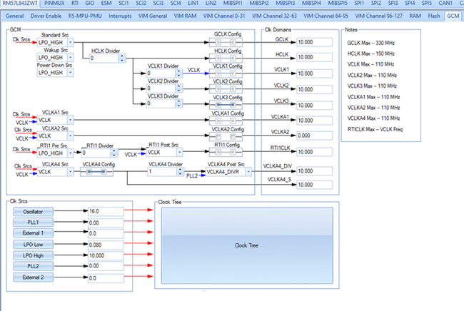

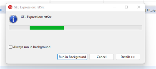

  • Hi Renan,
    This main() code will not generate exception. The exception might be generated in your _c_int00() function.
  • Hello QJ,
    Please see our customer feedback below:
    I haven't manually modified _c_int00, it was generated by HALCoGen. Here is the function code:

  • Hello QJ,
    Please see the customer update below:
    I added SW_RESET to line 132 in HL_sys_startup.c and commented out the SW_RESET on line 223.
     SW RESET was already included in getResetSource:
    resetSource_t getResetSource(void)
        register resetSource_t rst_source;
        if ((SYS_EXCEPTION & (uint32)POWERON_RESET) != 0U)
            /* power-on reset condition */
            rst_source = POWERON_RESET;
            /* Clear all exception status Flag and proceed since it's power up */
            SYS_EXCEPTION = 0x0000FFFFU;
        else if ((SYS_EXCEPTION & (uint32)EXT_RESET) != 0U)
            SYS_EXCEPTION = (uint32)EXT_RESET;
            /*** Check for other causes of EXT_RESET that would take precedence **/
            if ((SYS_EXCEPTION & (uint32)OSC_FAILURE_RESET) != 0U)
                /* Reset caused due to oscillator failure. Add user code here to handle oscillator failure */
                rst_source = OSC_FAILURE_RESET;
                SYS_EXCEPTION = (uint32)OSC_FAILURE_RESET;
            else if ((SYS_EXCEPTION & (uint32)WATCHDOG_RESET) !=0U)
                /* Reset caused due watchdog violation */
                rst_source = WATCHDOG_RESET;
                SYS_EXCEPTION = (uint32)WATCHDOG_RESET;
            else if ((SYS_EXCEPTION & (uint32)WATCHDOG2_RESET) !=0U)
                rst_source = WATCHDOG2_RESET;
                SYS_EXCEPTION = (uint32)WATCHDOG2_RESET;
            else if ((SYS_EXCEPTION & (uint32)SW_RESET) != 0U)
                /* Reset caused due to software reset. */
                rst_source = SW_RESET;
                SYS_EXCEPTION = (uint32)SW_RESET;
                  else
                         /* Reset caused due to External reset. */
                rst_source = EXT_RESET;
        else if ((SYS_EXCEPTION & (uint32)DEBUG_RESET) !=0U)
            /* Reset caused due Debug reset request */
            rst_source = DEBUG_RESET;
            SYS_EXCEPTION = (uint32)DEBUG_RESET;
        else if ((SYS_EXCEPTION & (uint32)CPU0_RESET) !=0U)
            /* Reset caused due to CPU0 reset. CPU reset can be caused by CPU self-test completion, or by toggling the "CPU RESET" bit of the CPU Reset Control Register. */
            rst_source = CPU0_RESET;
            SYS_EXCEPTION = (uint32)CPU0_RESET;
        else
            /* No_reset occured. */
            rst_source = NO_RESET;
        return rst_source;
    I continue to get errors -1170 and -2064 when debugging but a new error box comes up after the program load now:
    Does this mean the getResetSource function is now being triggered?
    Renan

  • Hello QJ,
    I closed some open projects, it didn’t really make a difference to my laptop resources (I have over 7 GB of RAM and about 95% CPU time available so that should be more than enough).
    I don’t get the GEL Expression: rstSrc error every time I run it but most times since I made that change. Maybe every ¾ times unless I push one of the reset buttons.
    nRESET does reconnect the debugger (it’s a bit tricky, I have to get the timing right) and send the program to resetEntry as shown here:
    However, once I push start then the errors return. I can step through for a bit. When it gets to getResetSource, the behaviour becomes a bit strange. If I keep clicking “Step Into” then it may go line 484 -> line 490 -> line 484. It often goes in the pattern forward, back, forward, forward. Then when I get back to line 113 in HL_sys_startup (rstSrc = getResetSource(); ) and click “Step Into” then the DAP errors start again but the next line is just “switch(rstSrc)” and that should cause any errors. Is this an indication that it’s getting errors triggered continuously? From the oscilloscope, it isn’t nRESET or nPORREST externally.
    nPORRST gives this error: CortexR5: Error: (Error -242 @ 0x0) A router subpath could not be accessed. The board configuration file is probably incorrect. (Emulation package 9.6.0.00172)
     Someone did say it could be a clock issue but I’m not using an external oscillator so I set it to use LPO_HIGH instead:
    Renan
  • Hi Renan,
    The HF LPO is normally used as a reference clock for monitoring oscillator clock frequency, and used as GCM clock source when oscillator or PLL fails.
    Using trimmed HF LPO (9.6MHz) should be ok.
