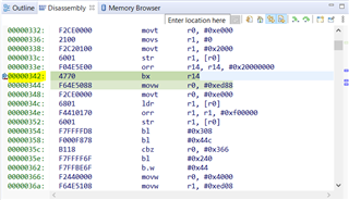

I'm now trying to create modified boot loader for our product, so I'm now debugging Tivaware boot_serial sample to know how bootloader works and how to fix it.
https://dev.ti.com/tirex/explore/node?node=ABcBenm2yzQjHEX.zyXVew__mic1X5.__LATEST
But at debugging, breakpoints don't work.
Running at step, when "bl" operation runs at bl_startup_ccs.s file, step running finishes and program goes to running state.
How can I use breakpoints, and step running at this program?
