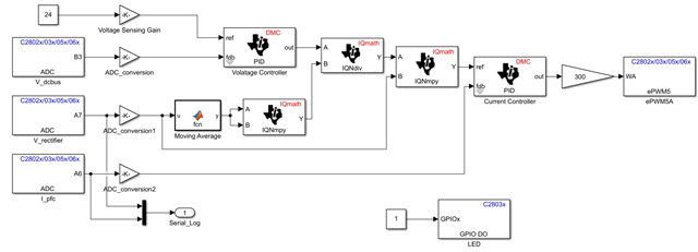

We have purchased PFC kit from TI and try to program it using Simulink and TI hardware support packages.
I have come across following example model from Simulink. Here all the calculations inside ISR has been done using fixed point operation.
I like to know is it mandatory to do all the calculation inside ISR in fixed point format.
and instead of using TI library block for PID,multiply,divide if i use equivalent simulink block which works on floating point number
then  am able to execute generated code inside ISR?
Aniket B.
  • Hi Aniket,
    I think it is a question more on the Mathworks side. From C2000 point of view, I think definitely you can choose to use the floating point block in Simulink. Are you saying that Simulink does not provide needed TI library block in floating point of view?
