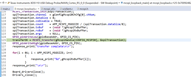

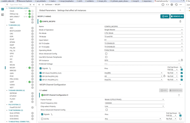

I wanna ask about SPI interface of AM243x. I use sysconfig to configure SPI for AM243 ALX Lauchpad.

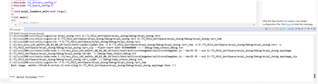

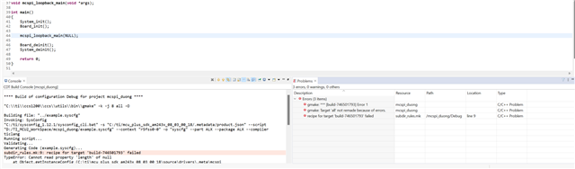

The problem is when i use SPI 4 pin mode, it work normally, but i don't wanna use CS pin, so i change to 3 pin mode and uncheck the CS pin ( you can see in the picture), and when i build project, it has some error with makefile.

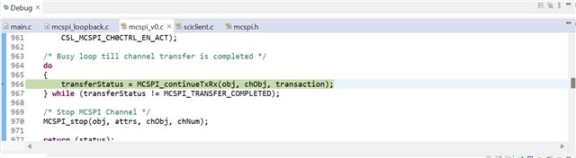

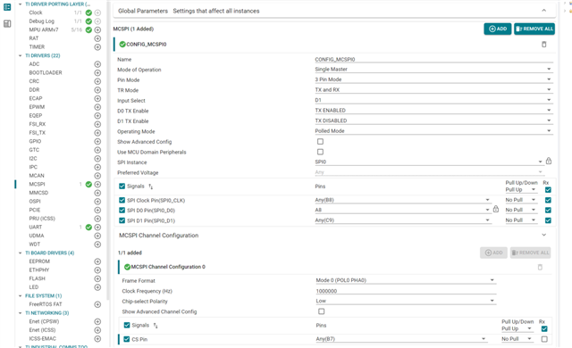

So i try to test other case, I still choose SPI 3 pin mode and hold the CS pin. Now, i can build the project ( no error with makefile) but spi doesn't work ( i tested it through uart )
Could you give me some advice to fix this problem ?
