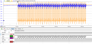

I have implemented the project [1]. Unfortunately the chip select does not go low during data transfer (see figure [2]). What can be the reason for this? Are there any solutions for this?

  • Your code looks ok for selecting CS_1 as the chip select:
          ui16TempReg = ((uint16)(~((uint16)0xFFU ^ (uint16)ui8CpSelect)) & (uint16)0x00FFU);
    But, why do you use the same buffer number as the start buffer of all the TGs (1~7)? Which TG is used for Data TX and RX in your application?

    Did you try the MibSPI functions generated by HALCoGen?
    Yes I tried it with Halcogen and found that on my TSM570LC4357 development kit (www.ti.com/.../TMDX570LC43HDK) no bit toggle is possible on CS0, CS1 and CS2. With CS3 a bit toggle is possible. With CS3 SPI messages can be sent.
    Possibly there is a HW error here. What do you think?
    Thank you very much.
    Kind regards
    Patrick
  • Hi Patrick,
    There is a DIP switch on HDK. The SPI1CS0, SPI1CS1 are routed to the expansion connection only when the USB_HOST and Ethernet on DIP switch are turned "OFF".
    thank you for the information. Where can I find this information?
    Thank you in advance.
    Kind regards
    Patrick
  • Hi Patrick,
    From the HDK schematics. After you switch off USB_HOST and Ethernet (DIP switch S2), are you able to pull MibSPI CS0/1/2 pulled LOW?
