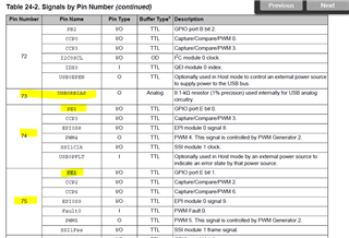

So I'm seeing some incredibly unusual behavior from several LM3S8C62s purchased directly from Digikey (not marketplace) as part of an effort to bridge an existing product's supply-chain issues until redesign can happen. Using Stellarisware drivers, direct software register manipulation, and direct register manipulation via CCS, it appears the 100QFP footprint does not match the datasheet for some pins.
For example, I enable the gpio port E peripheral, set the GPIO_DIR register to 0xFF and begin toggling GPIO_DATA between 0x2 and 0x0. This should be toggling pin PE1 which the drawing indicates is pin 73. Instead, pin 75 toggles. Likewise, setting GPIO_DATA to 0x1 should set PE0 on pin 72, instead pin 74 toggles. This is just one example, and it appears much of Port E is scattered around on the wrong pins according to their location on the datasheet.
I've confirmed the Stellarisware and my register writes are going to the correct address per the datasheet, and this effect also happens when manipulating the peripheral registers via the CCS gui, eliminating any question about user software. To confirm I didn't have a mislabeled part, I read out the DID registers and they matched the datasheet values for the LM3S8C62.

So assuming this BSDL file is close-enough: https://bsdl.info/view.htm?sid=87280194274b27e188ca59b002289d77 there's seriously something wrong with this part's internal design. I run this code:
SysCtlPeripheralEnable(SYSCTL_PERIPH_GPIOE);
GPIOPinTypeGPIOOutput(GPIO_PORTE_BASE, GPIO_PIN_1); //0x40024000, 0x00000002
GPIOPinWrite(GPIO_PORTE_BASE, GPIO_PIN_1, GPIO_PIN_1);
Which the datasheet clearly shows in both the table and diagram that PE1 is on pin 73, but this JTAG boundary scan cell and physical pin toggles high:
"PE3_PhA1:        75, " &
"     1  (BC_1, *,              CONTROL,   1 ),                         " &
"     2  (BC_1, PE3_PhA1,       OUTPUT3,   X  ,      1,     1,     Z ), " &
"     3  (BC_1, PE3_PhA1,       INPUT,     X ),                         " &
This part is misbonded/datasheet is wrong?

  • Digi-Key is still investigating, however TI support did dig up the actual BSDL files for the LM3S8C62 which are different from the LM3S8962.  The chips I have in hand are at least misbonded (I agree, probably counterfeit given the invalid lot trace code).  The boundary scan cell for PE1/pin 73 is on physical pin 75, IO cell for PE0/72 shows up on physical 74, just like the cortex sees too.  Someone must have used the wrong wirebond pattern while (re)packaging the die, which is definitely a first for me.
    I'm going to mark this as resolved because regardless of whether it's counterfeit, I now have a satisfying explanation for why my IO is in the wrong spot. Bummer.
