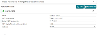

So I noticed that no matter how I configure the Watchdog via SysCfg or manually, it just does nothing.
This is the configuration I used. Also it does not change if set to 100% or any other value. A warm reset is never issued. At first I tried setting all the stuff manually since SysCfg-usage really is not practical for our abstraction-architecture.
So I tried the following (just copied the stuff from generated files):

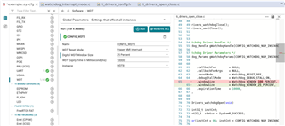

Since this did not work I trie using only the generated stuff. But its just the same. It does not work.
We are currently using the SDK with version 08.02. since we rely on some external third-company-libraries which also use the 08.02 -SDK.
I will for now implement a HW-Timer for a watchdog-behaviour myself, but this should be fixed.
