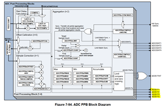

    I agree that the OTUPUTXBAR can route the events 1 to 4 from ADCs to ICSSM INTC. However, the events of the ADCs are, from my understanding, the outputs of the PPB modules and not the end of conversion interrupts. Is it correct?

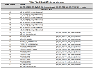

    Secondly, on the same topic, how is it to understand the table 7-64 in TRM section 7.2.7? Events 0 to 15 are generated by the PRUs or ICSS peripherals, then the events 32 to 63 are quite difficult to understand because they have the prefix "pr0_" that does not match with the doc of the OUTPUT XBAR or the ICSS XBAR. So reading you answer, I understand the following:
    • For ICSS_MII_RT_REG:MII_RT_EVENT_EN=1:
      • Control SS Output Xbar [15:0]   -> pr1_slv_intr<31:16>  -> System_event[63:48]
      • PRU-ICSS XBAR INTR [15:0]   -> pr1_slv_int<15:0> -> System event[47:32]
    • For ICSS_MII_RT_REG:MII_RT_EVENT_EN=0:
      • Control SS Output Xbar [15:8]   -> pr1_slv_intr<31:24>  -> System_event[63:56]
      • PRU-ICSS XBAR INTR [15:8]   -> pr1_slv_int<23:0> -> not mapped as system event
    Is my understanding true?
    Yes, it appears I was mistaken about ADC EOC interrupt routing. Reviewing this more carefully, I now understand:
    • ADCn.EVTINT : OR'ed combination of 4x PPB ADCEVTINTx for each ADCn, n=1..5. Routed through INTXBAR  VIM.
    • ADCn.INT1-4 : 4x configurable interrupts for each ADCn, n=1..5. Routed through INTXBAR  VIM.
    • ADCn.EVT1-4 : 4x PPB events for each ADCn, n=1..5:
      • Routed through PWMXBAR → ICSSM GPI
      • Routed through OUTPUTXBAR  ICSSM INTC.
    Yes, this is correct.
