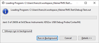

Also, a window pops up:
It stays stuck in this state for a while, until finally the CCS gives up with another bunch of messages:

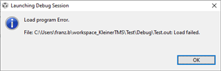

| Texas Instruments XDS2xx USB Debug Probe/IcePick : Target must be connected before loading program. Texas Instruments XDS2xx USB Debug Probe/Dap : Target must be connected before loading program. CortexR4: GEL Output: Memory Map Setup for Flash @ Address 0x0CortexR4: GEL Output: Memory Map Setup for Flash @ Address 0x0 due to System Reset CortexR4: Error: (Error -1141 @ 0x3E418) Device is not responding to the request. Reset the device, and retry the operation. If error persists, confirm configuration, power-cycle the board, and/or try more reliable JTAG settings (e.g. lower TCLK). (Emulation package 7.0.48.0) CortexR4: Error: (Error -1141 @ 0x3E418) Device is not responding to the request. Reset the device, and retry the operation. If error persists, confirm configuration, power-cycle the board, and/or try more reliable JTAG settings (e.g. lower TCLK). (Emulation package 7.0.48.0) CortexR4: Trouble Halting Target CPU: (Error -2062 @ 0x0) Unable to halt device. Reset the device, and retry the operation. If error persists, confirm configuration, power-cycle the board, and/or try more reliable JTAG settings (e.g. lower TCLK). (Emulation package 7.0.48.0) CortexR4: Error: (Error -1141 @ 0x3E418) Device is not responding to the request. Reset the device, and retry the operation. If error persists, confirm configuration, power-cycle the board, and/or try more reliable JTAG settings (e.g. lower TCLK). (Emulation package 7.0.48.0) CortexR4: Trouble Removing Breakpoint with the Action "Remain Halted" at 0x8000128: (Error -1066 @ 0x8000128) Unable to set/clear requested breakpoint. Verify that the breakpoint address is in valid memory. (Emulation package 7.0.48.0) CortexR4: File Loader: Memory write failed: Target failed to read 0x080002E8 CortexR4: GEL: File: C:\Users\franz.b\workspace_KleinerTMS\Test\Debug\Test.out: Load failed. |

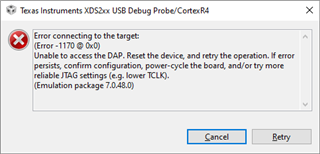

And I get a final popup window:

| Texas Instruments XDS2xx USB Debug Probe/IcePick : Target must be connected before loading program. CortexR4: GEL Output: Memory Map Setup for Flash @ Address 0x0CortexR4: GEL Output: Memory Map Setup for Flash @ Address 0x0 due to System Reset CortexR4: GEL Output: Memory Map Setup for Flash @ Address 0x0 due to System Reset CortexR4: File Loader: Memory write failed: Timed out waiting for target to halt while executing wr_pll.alg CortexR4: GEL: File: C:\Users\franz.b\workspace_KleinerTMS\Test\Debug\Test.out: Load failed. CortexR4: GEL Output: Memory Map Setup for Flash @ Address 0x0 due to System Reset |

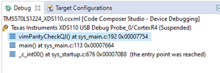

Edit2: Uniflash seems to work now, if somewhat inconsistently. I can upload the .out file of my project, read memory and perform a chip erase. I only made one real change: I severed the cold reset line, running from Pin 6 of the TPS65381A (NRES) to ball W7 (NPORRST) of the TMS570. However, the operations in the Uniflash seem somewhat unreliable and I can't do step-by-step debugging...
