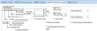

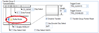

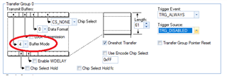

Hi, I tried to implement a data exchange on MIBSPI1 by connecting the board's SIMO[0] MIBSPI1 line with the SOMI[0] MIBSPI1 port.
In Halcogen I selected these settings:
I want to transfer 10 FRAME of 61 ELEMENT each.

    I would like to know one thing that are you verifying after receiving complete data to the receive buffer( mibSPI1_RX_Data)? I mean in your example we are sending 610 halfwords(61*10), did you verifying with oscilloscope after you receiving entire data of 610 bytes or not?
    Jagadish.
  • Hi Jagadish,
    I don't quite understand your question.
    With the oscilloscope from the time of the first send onwards, on the MOSI line, I keep seeing data sent infinitely.
    In the receive buffer, I can see the same values present in the transmit buffer, as I expect.
    I found the root cause for the problem, it was due to buffer mode you configured
    As we are disabling one shot transfer(we are disabling when frame count greater than 1) in our code right so the transfer group trigger will always present and we are configuring buffer mode as "continuous mode" so the behavior is as below
    The sequencer will transmit the data whenever it checks the transfer group buffer, so configure buffer mode as 3 i.e."skip single tranfer overwrite-protect mode" so that the data will transfer only when TX_FULL flag set i.e. new data coming from DMA and receives only when RX_EMPTY flag clears.
    So please use above mode and let me know the result. I tested at my end and it worked fine for me.
    Jagadish.
  • Hi Jagardish,
    the solution you proposed seems to work well! Thank you!
