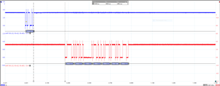

    I have run into a timing issue. When "M" is transmitted on uart2 it takes about 300us for the slave MCU to transmit data back to the main microcontroller.
    BLUE => UART2 TX, RED UART2 RX
    The uart2 interrupt handler is called again, but it does not receive the data that the slave is transmitting.
    uart2_cmd is consistently filled with 0, 32, 65. While the slave mcu is transmitting 62,45,0,40,162,245,60.
    I thought about adding a timer that would delay sending the "M" character to the slave MCU while uart switching is taking place.
    Do you have any suggestions on how to fix this timing issue?

    Using a computer I am able to send the string "M A". The application sends out an "M" character repeatedly on port A and D simultaneously. Using an oscilloscope I can confirm that data is being received in response to the "M" character being sent. The problem is the UARt2 interrupt handler is only called when data is received on port A and not on port D. Below is the UART2 interrupt handler,

    I was reading through the ROM user guide and I may have found an answer to the problem.
    If the same signal is assigned to two different GPIO port pins, the signal is assigned to the port
    with the lowest letter and the assignment to the higher letter port is ignored.
    So I guess this isn't going to work? What are your thoughts?
    Allan
  • Hi Allan,
    Thanks for posting the full code, that definitely helps. But more over thanks for finding that note from the ROM User's Guide. That's what I was expecting to be how the device handles the dual port assignment but couldn't find a confirmation for yet.
    Correct that it won't work as it is done currently. You would need to use the switching function so that only one port is assigned to UART2 at a time. Or use a different UART module where you won't run into these sorts of complications (I'm presuming a hardware layout is gating this, but resolving that may have to be the long-term solution...)
    Ralph Jacobi
